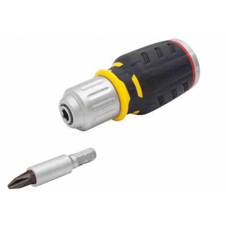

PostPosted: Thu 11 Jan 2018 - 14:30    Post subject: Modifications Leatherman Reply with quote
Steff wrote:
Ou trouver ce cliquet ?
WEBDAF
Joined: 11 Jan 2018
Posts: 13
Localisation: Cagnes sur mer
PostPosted: Fri 12 Jan 2018 - 10:34    Post subject: Modifications Leatherman Reply with quote
je pense avoir trouvé le donneur :
